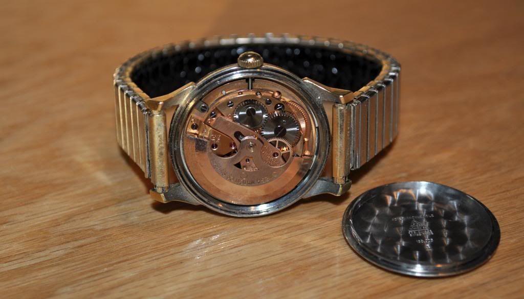

Hey guys, here are some pics of a vintage Omega Constellation Pie-Pan model that I've recently inherited from my dad. I'm new to the watch collecting, and this and a few others of his have really sent me into looking at vintage watches.
- Omega Constellation
- Automatic chronometer
- probably not original band - dad like these black metal bands
- Not sure on year, but I know it's been in my dad's possession for quite some years now.
- the wind knob - one pull to set time, two pulls to set date (date automatically changes when pulled out - need to keep pulling to change date - not wind)
Does anyone know anything about these models? Anyway to value them? I know it's pretty beat up - any way to refinish them or polish the glass?
Thanks for any information!
28,291 Posts
Yes, there's value to them - except yours is missing the gold observatory medallion on the caseback. :confused1: It also has a replacement crown. The push-pull date setting tells me it's a caliber 564, one of the best mass produced movements of all time. The crystal is plastic and can be polished, but have a watchmaker do it as part of a service. Don't use the watch with dried up oils or you'll ruin a nice heirloom.

Hmmm....I thought it was funny that the medallion that I see in all the other pictures was missing....any chance you think I can replace the parts if i find them on ebay or something to restore it?
I wasn't sure on the crown. It has the Omega symbol on it, but i noticed it was a slightly different shape.
Anyway to know what the original strap looked like?

Check eBay for parts. The correct crown is 10 sided and you might even find a replacement caseback. Just be sure to enlist some help from a watchmaker to buy the correct parts and install them. Might as well get it done in one shot while you have it serviced.

I believe that the back is incorrect since mine says 168.005, and none of those models are Constellations.
And I believe you are correct about the crown. I believe this is the correct one:
