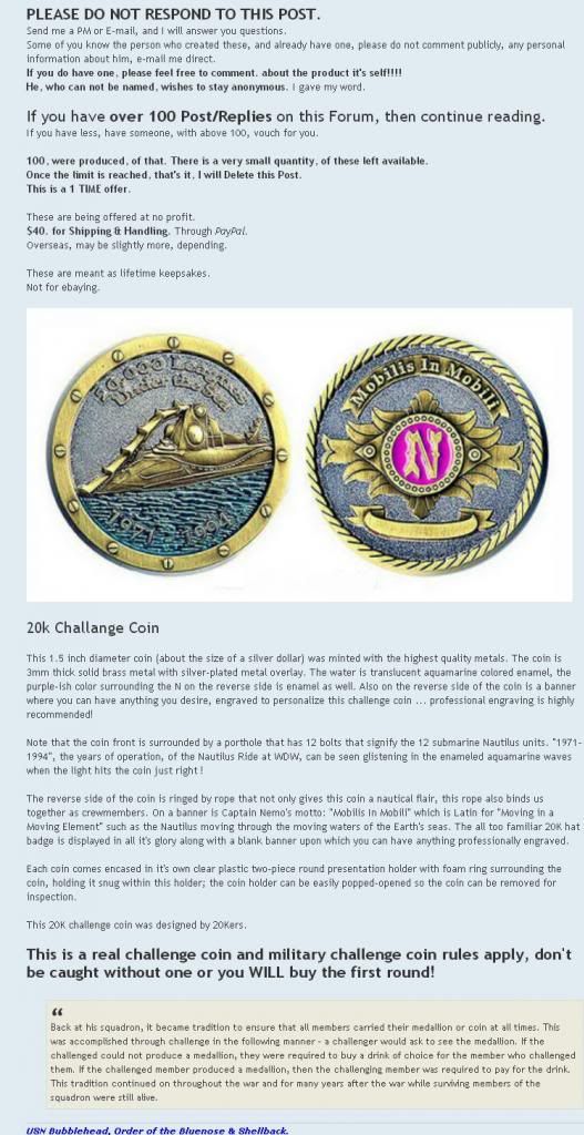

I had done something similar, with a Tribute Challenge Coin, on another Forum I belong too.
It has to do with, Harper Goff's version of the Nautilus, from Jules Vern's 20KLUTS, made by Disney.
That's when PayPal, first Penis Poked me in the eye.
:w00t:
See the Screen Grabs Below.
