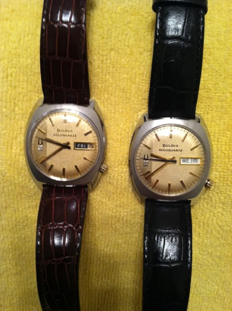

My new set of twins: Tell me what you think
Both in NOS Accuquartz cases. Both need SS crowns - one on the way. Dials & hands exactly alike and in mint condition. Left is a true Accuquartz, right is a quartz conversion. Notice the difference in the day/date wheels. NOS Accuquartz band with Bulova signed buckle on the way.
I posted about the quartz conversion watch in a recent thread. A few days ago I found a true Accuquartz mvt. on The Bay with the exact same dial & hands. Listed as running condition unknown because correct battery not available. Cased the mvt., installed a battery and it hummed but no second hand sweep. Installed the stem/crown per service manual, pushed in the crown and the second hand started to move. Movement looks very clean but will be serviced in the future. Running well. Regulation might need a tweak but want to double check with my watchmaker on this caliber mvt. because of the quartz crystal tuning capacitor assembly. I do have the 224 Tech Bulletin. The usual regulators on the tuning fork are balancers in the Accuquartz movement and are only adjusted so that the tuning forks vibrate in close harmony with the frequency of the quartz crystal. Fun, huh?!

I think the dials look very nice on your twin watches, Golden Metalic going on and along with the Diamond bet them watches are real pretty the way the light shines off of them..

Thanks! Yes, the gold tone is subdued and pretty does look good in the sunlight.
