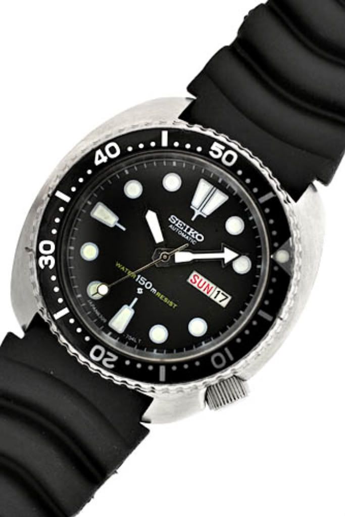

1. Is the presence of a beveled day/date window which this has.
2. Is the uniformity & silver sheen color of the upper-dial Seiko/Automatic wording font as well as the matching silver color mid-dial 150m font and Suwa symbol. (Also the centered and crisp shape and size of the Suwa symbol)
3. The shape and uniform thickness of the 12 O'clock hr. marker sword and handle thickness.
4. The thickness and uniform cross hatched linen texture of the lumen in the hr. markers, as well as the crisp clean shape and smooth bends or corners of the Markers themselves. Notice the thickness and the length of the staff's extending from the 6/9/12 O'clock markers.
5. The shape and color of the centered Water-Resist text font and the known colors of the font which in mint or new examples was dark crimson or maroon in color, then fades to the other known and commonly seen colors of red, orange, yellow as it ages & fades from exposure to sunlight.
6. The shape & size and wording of the lower dial code font, which reads (Japan 6306) between the 6-7 hr and (-700 L T) between the 6-5 hr marker. This text is always lower in height and rest below the bottom of the 6 O'clock marker cup and never touches it or advances above it. The color of this dial code text also matches for the most part the color and sheen of the silver text elsewhere as previously mentioned on the dial.
First we'll start with the real deal, the Original 6306 diver:
The borrowed pic below shows what a original authentic 6306 example dial looks like. I'm sure many of you know what things to look for on a dial to identify and tell if it's real or not by now with a few pointers mentioned above.

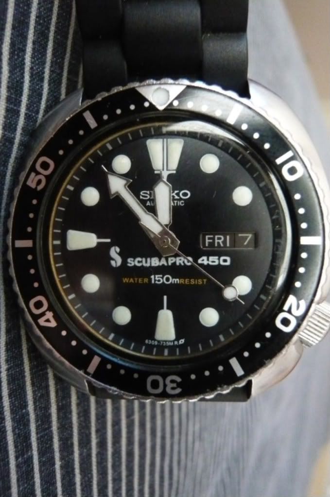

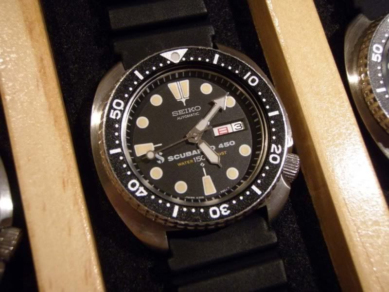

Below are a couple examples of original authentic Seiko 6306 Scubapro 450's, which are identified in the same way as the regular 6306 diver I mentioned above, with the addition of the Scubapro 450 font text to be examined.
The Scubapro 450 text is thick and appears to be the same thickness as the original lumen on the hr. markers, and it's letters and size is uniform and extends from the inner edges of the upper 8 lower inner 9 O'clock hr marker across the dial to the inner top side edge of the 4 O'clock marker. The base black color background of the dial is uniform and exhibits a nice even Matt black color and texture. Notice the matching silver grain paint color of the Suwa symbol and the mid dial 150m text font as well as the upper Seiko automatic font text. Notice where the Suwa symbol resides in relation to the 150m text directly above it and how it's perfectly centered. The lower dial code font on the Scubapro 450 on the bottom right side always reads (-700J T)

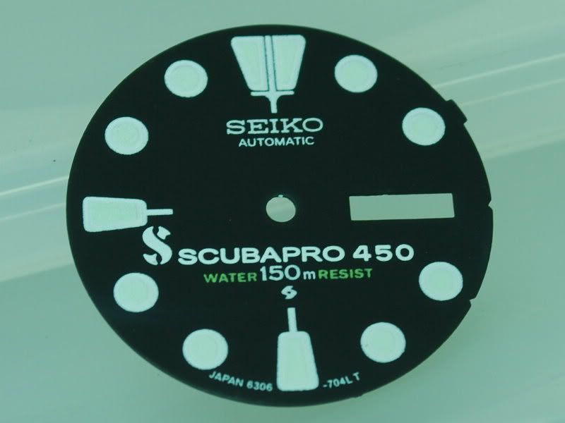

Here we have 2 different fake or aftermarket 6306 SP450 dial pics below:
We have a aftermarket or fake dialed example which lacks some of the quality ID points of the original regular 6306 diver, as well as very different looking details compared to the Original Scubapro 450 above.
Of interest to note: the dial below does have a beveled day/date window which tells me that this could be and is more than likely a repaint or redial?
Notice the thin font of the 12 O'clock Sword & handle, notice the sharp pointed corners of the 6,9,12 hour markers. The Suwa symbol is off centered and the silver paint isn't silver at all but looks white in appearance.
The lume appears to have been relumed & has false aged discoloration. The Japan 6306 lower dial code font is too thick and positioned higher than it should be. The Scubapro 450 text is distorted and doesn't have the proper full extension or texture, and also appears to be offset or unlevel and slanted down on the right. (This dial is a fake, and shows itself to be a redial or repaint)
