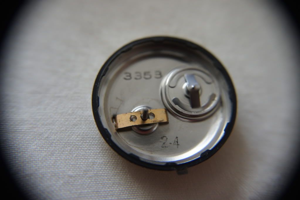

Now thankfully my watch still depicts the original 'ink' lettering which in this case is '3353'.
This is very useful in identifying the watch and in particular replacement parts. Some watches no longer have this 'ink' mark for a variety of reasons such as cleaning etc...... other watches have them engraved from the factory. Some owners inscribe the number into the caseback to aid in identification.
From this number '3353' I can ascertain that this is a genuine Spaceview model as listed in this 1974 Parts catalogue.
Now what I would say and this is based on research also, some Accutron Spaceview watches do not appear on that list.....WHY???? My assumption is that these Spaceview watches may perhaps be 'conversions' I will leave you decide.........
