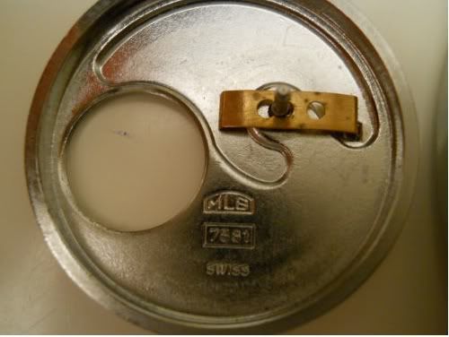

I am looking for information regarding the 1975 Stainless Steel Anniversary Spaceview.
From researching the net, it appears to be a a rare watch with the 'Gold' coloured case being the more common out of the two.
Another source claims that only 40 exist :001_tt1::001_tt1::001_tt1:
What are your views ?
Here is my latest acquisition "Opinions please"
As soon as I receive the watch it is going directly to a specialist for a full service, therefore I will have full piece of mind ensuring that this beauty will run flawlessly for another 37 years.
I would also like to replace the strap as I am a purist, therefore 'what strap would you use?'
The watch shows signs of having a blue protective film over the stainless steel, and I have been told that it was rarely used, however it was shown to be working and keeps time well.
Here are some pics of the watch, the dateless mechanism and the '7581' cover

Hi
The hand on these models for 'whatever' reason feature a small cut out, why ? Im not sure.
Some of the 'cushion' models also display this feature.
Maybe it was aesthetically pleasing to the eye ?
The mystery of why, when, what and where continues lol

648 Posts
Discussion Starter · #8 ·
Nice looking watch! A great find. My Anniv. Spaceview is in a GP case and does not have the slot at the end of the minute hand. Like Skypilot, I only remember seeing hands w/o the slot on U.S. watches. One that Boomertime sold in the past and one he has for sale now do not have that slot. I had a pic sent to me by an Accutron collector in the U.K. showing his SS Anniv. watch. If I still have it, i'll check that one.
Found the pic! It shows both a SS and a GP 214 Anniv. Neither has a minute hand with a slot. He also has a Ladies 230 Anniv. and a 218 Spaceview Anniv.
You guys are :sneaky2::sneaky2: Good eye for detail too !!!
It is correct that Accutron were never consistent 'with anything' lol.
The Anniversary Spaceview on mybob.net (Is gorgeous) however this is a USA version.
You will note that on the rear of my version I have a serial number. (Ignore the blue protective tape)
This is consistent with swiss models.
The other anomaly are the hands :sneaky2: Swiss versions have the tapered hands and the US version has the 'stick type' hands.
My friend who is an old watch maker and member of the Horology Institute, remembers these old watches as he used to sell them back in the day. He is a great font of knowledge.
Hopefully this post will help others identify the 'why' 'how' 'is it' aspects of this wonderful brand.
If anyone else has any feedback then please contribute :biggrin:
