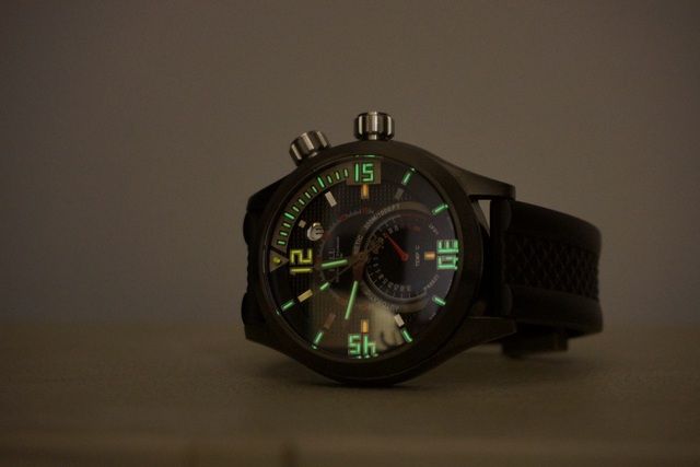

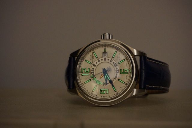

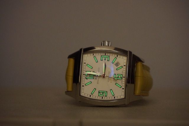

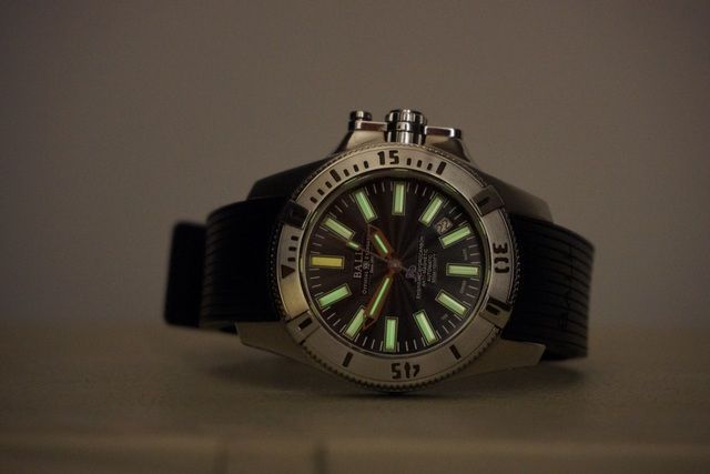

I took some pictures today to share different Ball watches purchased over the years.
To ensure consistency, the camera is set to manual mode (f5.6, 1/16s, ISO1600) and here are the pictures:
Engineering Hydrocarbon - bought in 2005 (9 years old)
Trainmaster Voyager GMT - bought in 2006 (8 years old)
Engineering Master TMT - bought in 2008 (6 years old)
and my wife's Conductor Ltd - bought in Dec 2011 (3.5 years)
It is difficult to capture the differences in picture. In person I would say the 3.5year conductor is probably 20% brighter than the 9 year old Hydrocarbon.
The 9 year old Hydrocarbon is still legible in cinema so its good enough for me.
Hope this helps.
