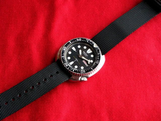

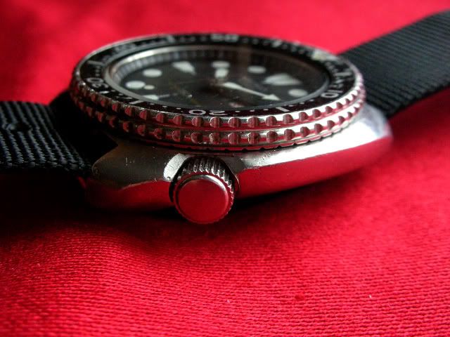

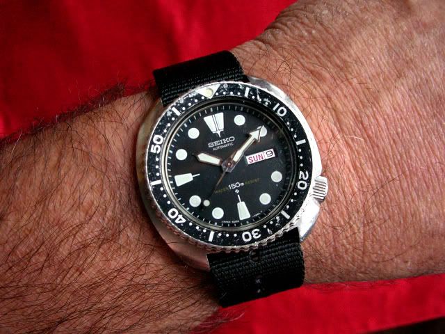

Just picked up a Seiko 6309-7049. :biggrin:
(i didn't even know what it was called before my research here)
First thing i did was to take it to my watchmaker and get it cleaned and serviced along with new seals and a pressure test.
It runs great ... about +3 seconds a day :w00t:
I know nothing about Seiko's except for my monsters but saw this and had to have it. :001_tt1:
Its pretty beat up .......... should i change the bezel? Where would i get one if i should? Its a got a few scratches in the crystal, should i get that changed as well? Again where do i find one? Should i polish the case? It appears that it never has been polished as all edges are still sharp. :confused1::confused1::confused1:
Anything you can tell me would be greatly appreciated :thumbup:

Great find, looks in good condition other than the cosmetic stuff.

That is a nice classic diver worth restoring, especially since it is keeping very good time. Love the Doxa style casing, I think a replacement bezel will do wonders for a start.

Yes, I agree. This watch is way too nice to be treated as a "beater." If the bezel is not that bad, just a new bezel insert may be all that you need along with a new crystal. Anyone can go out and buy a nice Seiko, but a vintage Seiko in good condition is not always that easy to find. Take good care of your new treasure! :thumbup1:

I'd leave the bezel as it is.
There's a lot to say for pristine watches, but "salty" watches say a lot about themselves.

I am thinking you guys are right, i do wear my watches anyway ..... no safe queens in my collection.
I might just change out the crystal if i can find one that fits and maybe upgrade.
(searched your links KW and couldnt find one for my case :sad: )
