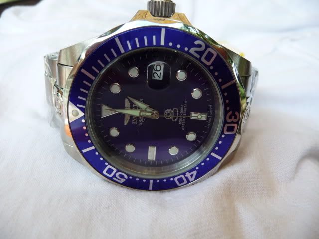

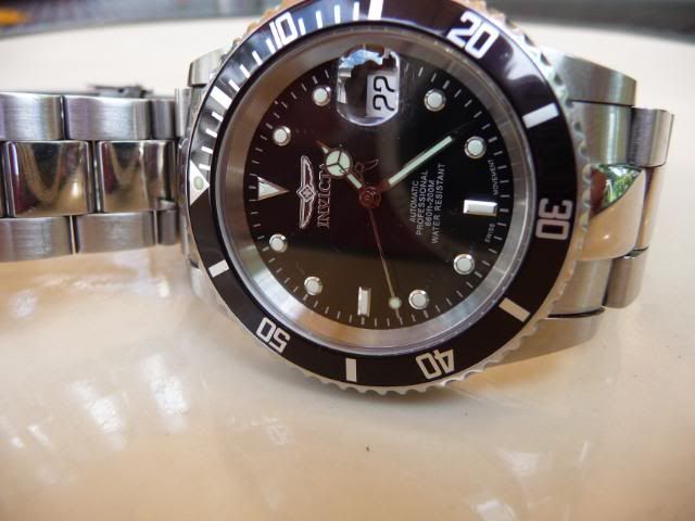

Running a very unscientific accuracy test comparing my 9937 with the SW200 and my Grand Diver with the NH35A. After 18 hrs on day one the SW200 is far in the lead being down one second (-1) against the Atomic Clock. The NH35A clocked in 12 seconds slower. I was somewhat surprised since the SW200 is 4-5 years old. I'll try to leave them in the same orientation overnight. I'm going to hand wind each auto daily just to make sure both are at full power. Think I'll throw a couple quartz movements in there just for kicks. And no, I don't plan on testing each auto in four or five different orientations, that's just overkill.
Observations: The SW200 seems to have a smoother sweep. The NH35A seems to have that slight hitch like the 8926. That said, I'd prefer the sweep of any of the automatics to the tick of a quartz. Again, just personal preference, and this from a guy with many more quartz than autos.
9937 with SW200
Grand Diver with NH35A

I knew that the NH35A ran at a slower rate. The sweep is not objectionable, just noticeable when put side by side with the SW200. Haven't checked the time yet since I just got home. I'm not too concerned. I don't expect my automatics to keep up with my quartz. Of course nothing keeps up with my Casio Waveceptor.
Edited: Time span 33 hrs: The SW200 is still running 1-2 seconds slow. I consider that excellent and to be honest, better than I expected. The NH35A is still running about 12 seconds slow (got to figure +/- a second since I'm eyeballing the time :001_unsure: ) My 5040D and TMI VD53 are both spot on. I figure I need a much longer baseline to really check the quartz watches for accuracy. I know, two days do not a test make, this was just an quick check to see how the engines were running. I realize I need a much longer run to get a true test of accuracy. Then, too, the NH35A may need a break in period for a better comparison. I usally hack and sync my autos when I wear them anyway. I do have a greater appreciation for my SW200. It should not be able to keep up with my quartz watches, but I'm surprised at how well it's running.

Last post on this topic. I'm not so anal that I intend to sit and measure these watches daily (although if that's your hobby, more power to you). I expect my watches to keep reasonable time, but my life doesn't revolve around pinpoint accuracy. I've read that automatics usually aren't capable of keeping time as accurately as quartz watches, especially unregulated autos.
I am literally blown away by the 9937 with the SW200. After nearly three days since my last hack, the movement is still only two (2) seconds behind the reference atomic clock. The Grand Diver with the NH35A is now 28 seconds slow. I'm a little disappointed there, but again, I'll give it more time. The quartz watches, as to be expected, are within a second. I believe they're expected to run in the +/-15 second/month range anyway, so I'd need a month of observation to check them. Usually I reset my quartz when I correct the day at the beginning of the month.
