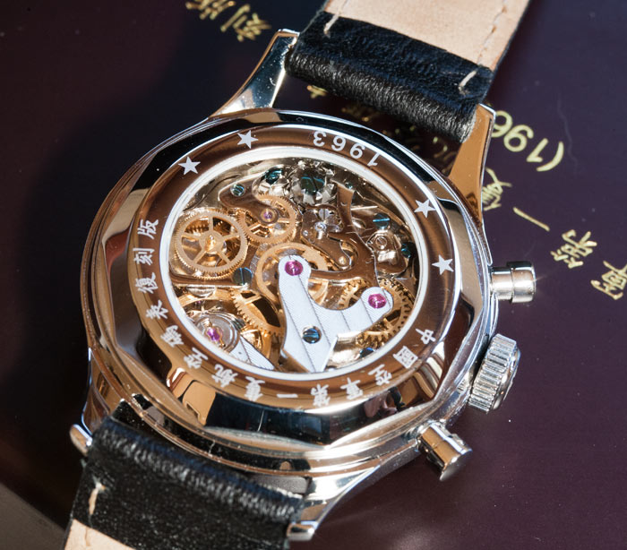

The back of the watch shows a screwed caseback with a display window, which in this case is really worth having, because the movement is fun to look at. I own two automatic chronographs of high quality, but this one is more fun than either to stare at, simply because there's no rotor to block the view.
The movement is a classic Venus 175 hand-wind column-wheel-operated two-register chronograph. It uses a jumping minute totalizer (as does my Zenith, but not my Ebel) at 3 in addition to the running seconds hand at 9. The wheels are nicely finished, and the chronograph levers are plated and polished. The bridge is decorated with a flycutter to simulate cotes de Geneve, but with a magnifier it becomes obvious that the pattern was cut and not the result of polishing. When comparing to the Zenith or Ebel movements, it's apparent that the decoration is on the top, rather than within. The parts that are not visible without looking past all those levers and gears are plain on the Tianjin movement, where they are as carefully decorated on the Ebel or Zenith where you can't see them as where you can. This one has a lot of surface glitter, but less deep beauty. But that doesn't undermine at all my fun when looking at it. It just says that you do get what you pay for.
Here the column wheel actuation is highlighted for those who have heard the term but haven't explored its meaning. Near as I can tell looking through the glass, the wheels were adjusted for proper engagement, and everything works smoothly. The actuation force for the start/stop pusher is about the same as for my Zenith, and the reset pusher requries almost no effort at all. The beat rate is 21,600. My watch runs pretty well--always well within about 8 or 10 seconds a day and positional variation seems to fit within about a 12-second window when fully wound. It's not ready for COSC but it runs pretty well for a $200 chronograph.
