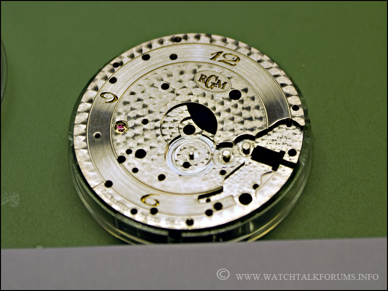

Here's some examples of engine turned dials:
This dial didn't quite pass RGM's quality standards, but it gives you an idea of what a finished product looks like:
Personally, I think RGM's "reject" dials look better than the 1st quality production of many watch manufacturers.

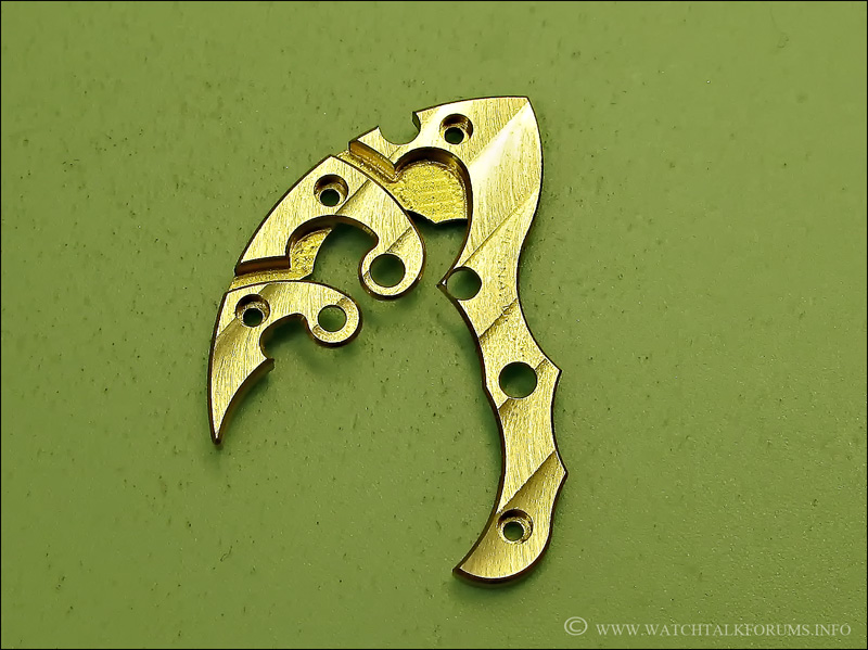

RGM is striving to pull more and more aspects of their watch production "in house" and has begun manufacturing the cases for the RGM Series 151 - a 38.5mm case:
Here's a couple of cases and case backs ready to be polished:
And here's some finished products:

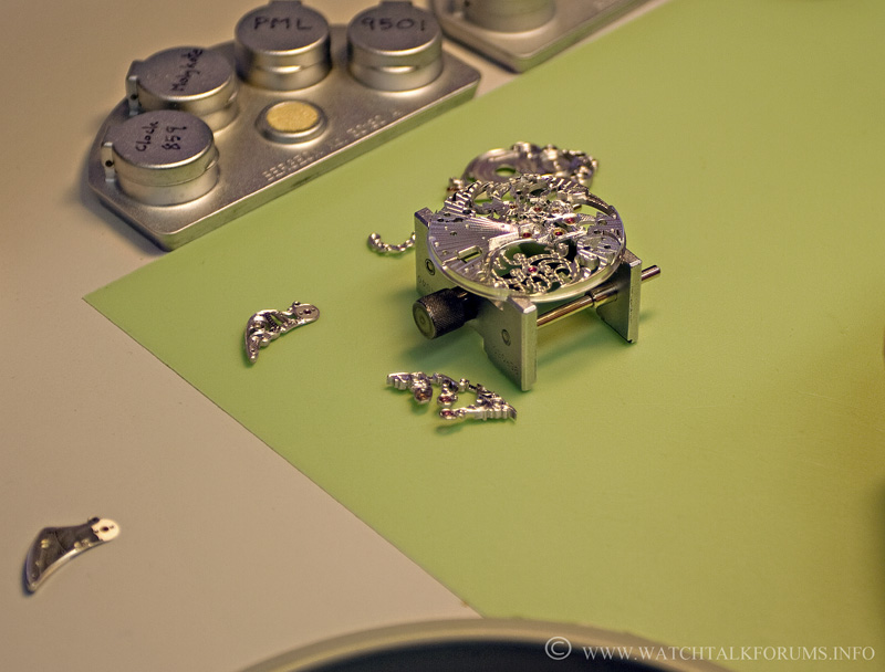

Once all components are either manufactured at RGM's facility or received from suppliers, watches are assembled. Here's some components from various RGM models ready for assembly:
